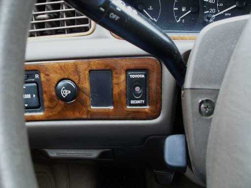

Kaddo Posted March 20, 2010 Share Posted March 20, 2010 Need help (desperately) to disable this annoying thing. There is no hidden button or switch, as in most cases. Only a flashing red light on the dashboard (see pic) I found the "black box" under the seat. It says: VIP Toyota Security Product # 237000 - 1340. It has two plugs, one with several wires, the other with just one. According to the original owner, this car never had a remote control. The reprogramming must be done without one, then. Any suggestions and comments on how I should go about disabling it will be greatly appreciated! (Yes, I checked with the local Toyota dealer: "Don't know"). Quote Link to comment Share on other sites More sharing options...
